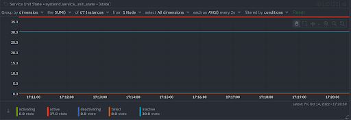

Whatever you specify will result in a time series for each data collection job, showing the health of the matching systemd units, and automated health checks that trigger alerts if a systemd unit goes into the “failed” state.
“Systemmd Service Liveness”
If you want to ensure a service is running no matter what, you could add your own alerts for the “inactive” state as well.
