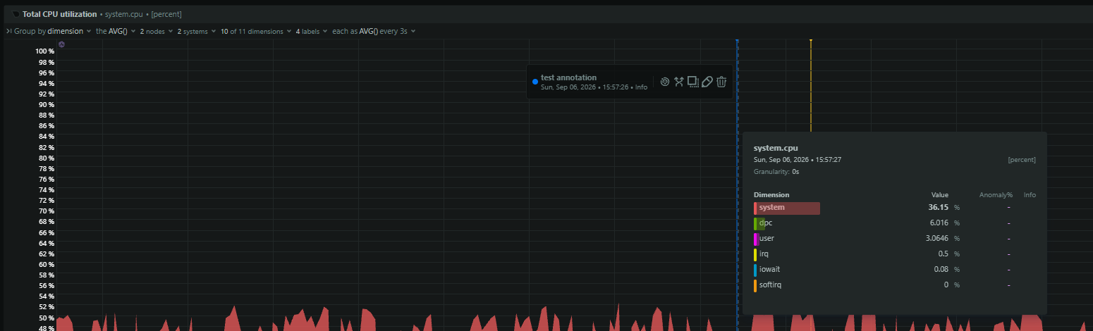

How Netdata helps
  • Per-second iostat metrics alongside MongoDB collector data let you overlay %util, await, journal sync latency, and checkpoint duration on one chart.
  • Pre-built alerts for WiredTiger cache dirty ratio, application-thread evictions, and available ticket ratio surface storage pressure before writes freeze.
  • Netdata overlays opLatencies spikes and disk saturation windows on the same chart, so you can see whether a latency jump started with await or with a lock holder.
  • Per-process I/O visibility helps isolate whether MongoDB or a co-located backup job is consuming disk bandwidth.
