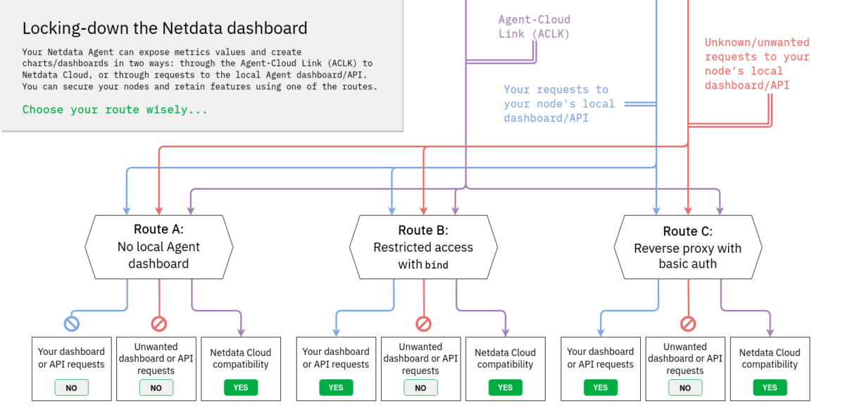

But let’s walk through some of the available routes for that VM running on DigitalOcean.
Down route A, you can turn the local Agent dashboard off. In our opinion, this is the best solution because it prevents anyone from accessing your local Agent dashboard at http://NODE:19999, but maintains the Agent-Cloud Link (ACLK) with your Netdata Cloud account for secure on-demand streaming of metrics values to your browser. You can still claim your node(s), view their single-node dashboards, view aggregated metrics together using the Overview’s composite charts, and much more.
Learn how to take route A.
  • Pros:
    • Nothing for anyone to see on port 19999.
    • Easiest setup (change a single line in one configuration file!).
    • Full compatibility with Netdata Cloud’s dashboards and features.
  • Cons:
    • No ability to view the local Agent dashboard.
    • No API.
Route B takes you to using the bind option to restrict dashboard access. With access lists, you can control exactly who, and from what source, someone can view your local Agent dashboard. This route is ideal for those who want to secure the local Agent dashboard from unauthorized access and see everything in Netdata Cloud, but also want the flexibility to build custom local dashboards or power other business processes with Netdata’s API.
Learn how to take route B.
  • Pros:
    • Leave the local Agent dashboard running, but restricted to only known networks or trusted external IPs.
  • Cons:
    • Requires more upfront configuration and knowledge of access lists.
    • Requires a relatively static IP or management LAN.
Route C is the original, and it’s still good: Put Netdata behind a reverse web proxy like Nginx, which then provides all sorts of value-added benefits like HTTPS connections and username/password authentication. A robust, dedicated web server like Nginx provides more stability and security, plus many more configuration options, which is why we use it in front of our London demo server. You’re also not limited to Nginx, as this route gels nicely with Apache, Lighttpd, HAProxy, and Caddy. You can still connect to Netdata Cloud, since the WSS connection works in parallel with HTTPS from your browser. It’s the best of all worlds, but it does take more time and Linux systems experience to do properly.
Learn how to take route C.
  • Pros:
    • Leave the local Agent dashboard running, with optional password authentication.
    • Leverage a dedicated web server’s additional features and configuration options.
    • Optional easy HTTPS/SSL with Let’s Encrypt.
  • Cons:
    • Requires the most upfront configuration, installation of new packages, and knowledge of web server configuration.
    • Requires some knowledge of TLS keypairs.
    • Often requires a domain name to associate with the node, which in turn requires some DNS configuration.
