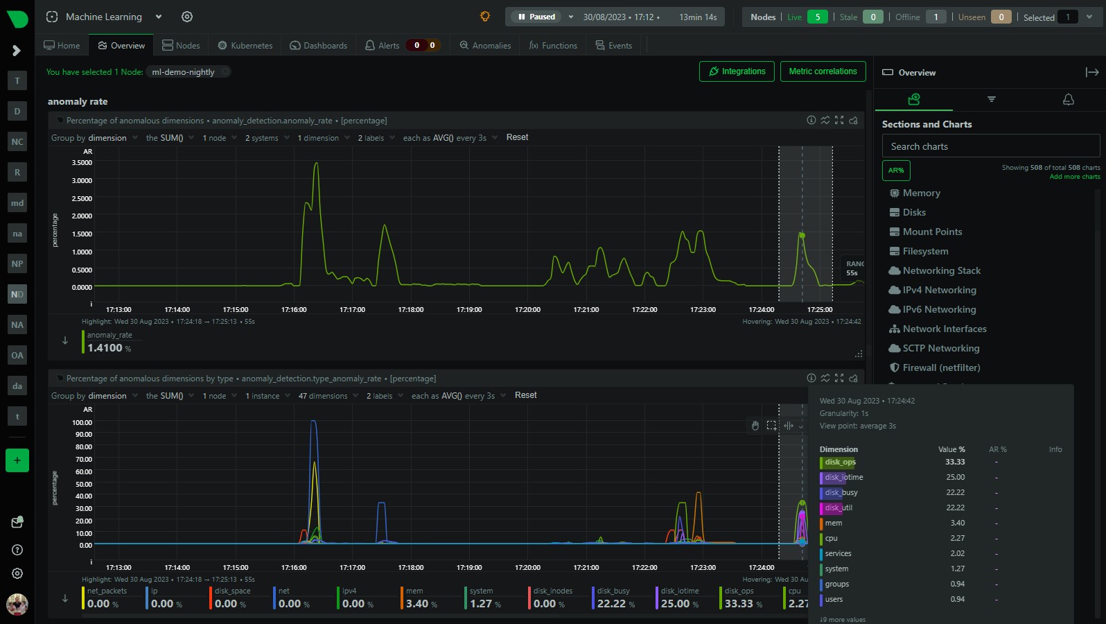

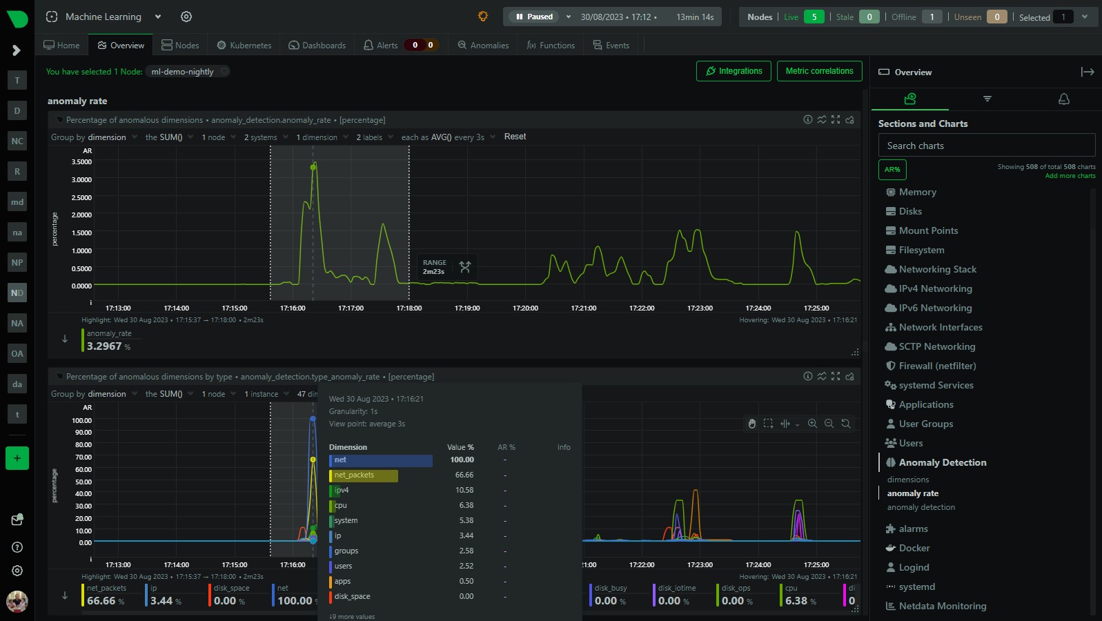

Here is an example of how you might find this useful. In the below screenshot we can see that within the highlighted area, the overall node anomaly rate has suddenly increased to around 3%. You can clearly see this in the anomaly_detection.anomaly_rate chart. This gives us an idea there is something going on, but not much more than that.
Now with the addition of the anomaly_detection.type_anomaly_rate chart just below, we can see that this spike is mostly made up of spikes within the net and net_packets type’s.
example1

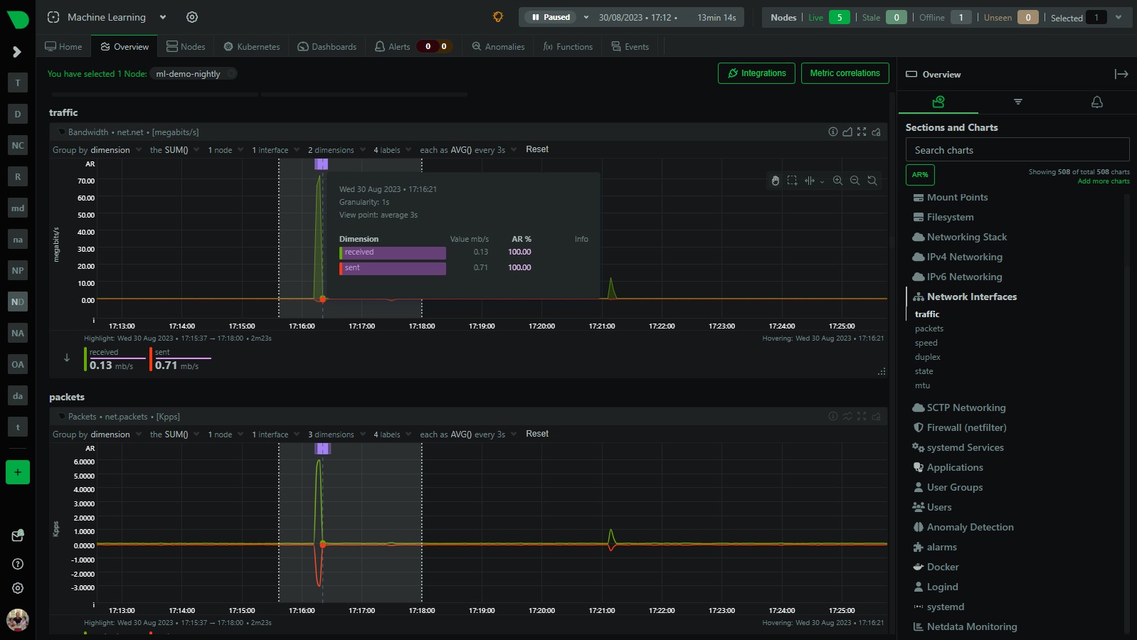

If we quickly navigate to the network related parts of the dashboard, sure enough we can see some anomalies in the net and net_packets charts where we have increases sent and received traffic that has been flagged as anomalous.
example1-net

Similarly, in the period following our initial anomaly i was doing some troubleshooting on my disks and so we also see a little spike in the node anomaly rate but this time the anomaly_detection.type_anomaly_rate chart is suggesting its something related to various disk related type’s.
example1-disk

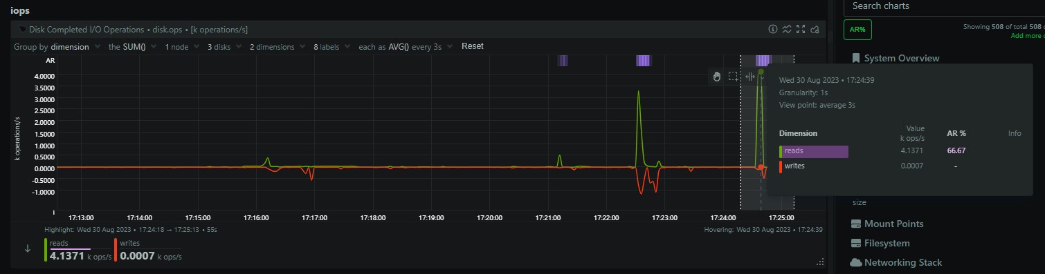

And, sure enough, looking at some of my disk charts i can see the activity that has been flagged as anomalous.
example1-disk-detail
