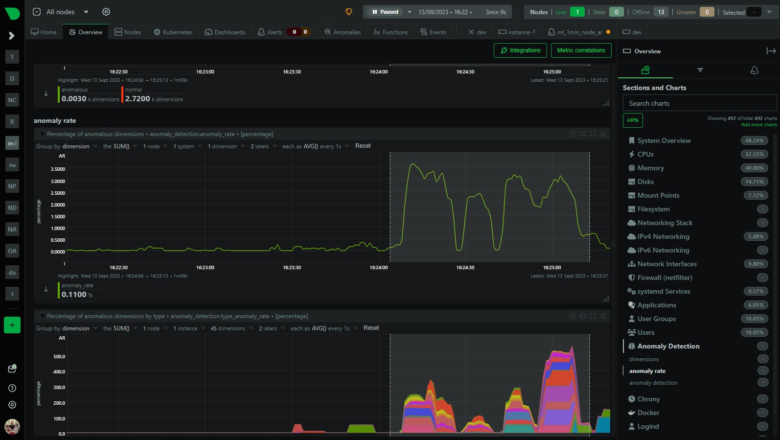

In the example below we can see that the node anomaly rate spikes to around 2.5% and shortly after the ml_1min_node_ar alert is triggered at a 1 min rolling node anomaly rate of 2.01%.

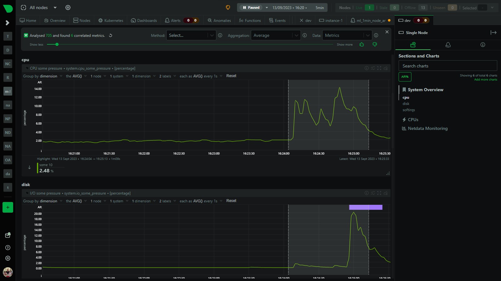

  1. Filter for the node or nodes relevant: First we need to reduce as much noise as possible by filtering for just those nodes that have the elevated node anomaly rate. Look at the anomaly_detection.anomaly_rate chart and group by node to see which nodes have an elevated anomaly rate. Filter for just those nodes since this will reduce any noise as much as possible.
  2. Highlight the area of interest: Highlight the timeframe of interest where you see an elevated anomaly rate.

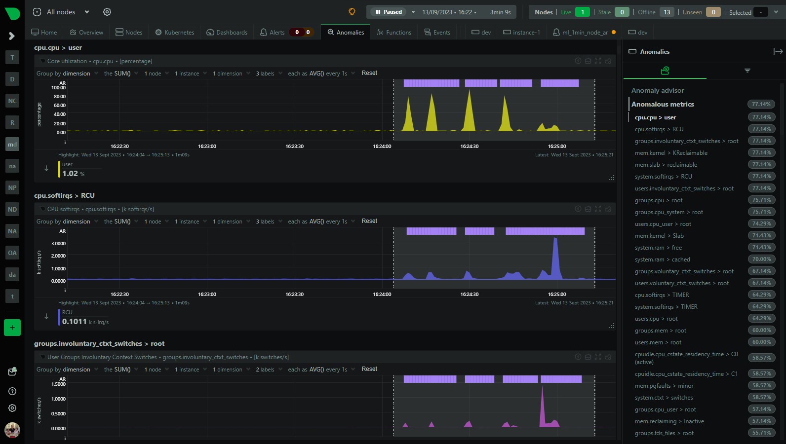

  3. Check the anomalies tab: Check the Anomaly Advisor (“Anomalies” tab) to see an ordered list of what metrics were most anomalous in the highlighted window.

  1. Press the AR% button on Overview: You can also press the “AR%” button on the Overview or single node dashboard to see what parts of the menu have the highest chart anomaly rates. Pressing the AR% button should add some “pills” to each menu item and if you hover over it you will see that chart within each menu section that was most anomalous during the highlighted timeframe.

  1. Use Metric Correlations: Use metric correlations to see what metrics may have changed most significantly comparing before to the highlighted timeframe.
