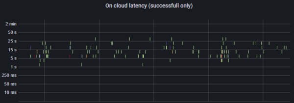

Below you can see the typical latencies on the default cloud based Metric Correlations service range from 5 to 25 seconds.
latency based on cloud microservice

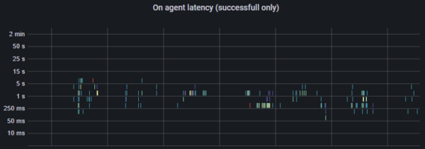

In comparison we can see that the latencies for the agent based Metric Correlations tend to be between 100 milliseconds to maybe 5 seconds typical upper range.
latency based on agent
