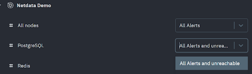

However, to go from a simple manual check executed once on a given node, to proactively monitoring host reachability, you need a proper monitoring tool. Netdata Cloud has the capability to send reachability notifications for any Netdata node that loses its connection to the cloud. You just need to change the notification settings of your personal profile to All Alerts and unreachable for every room you want to receive such notifications from:
host reachability - All Alerts and unreachable
